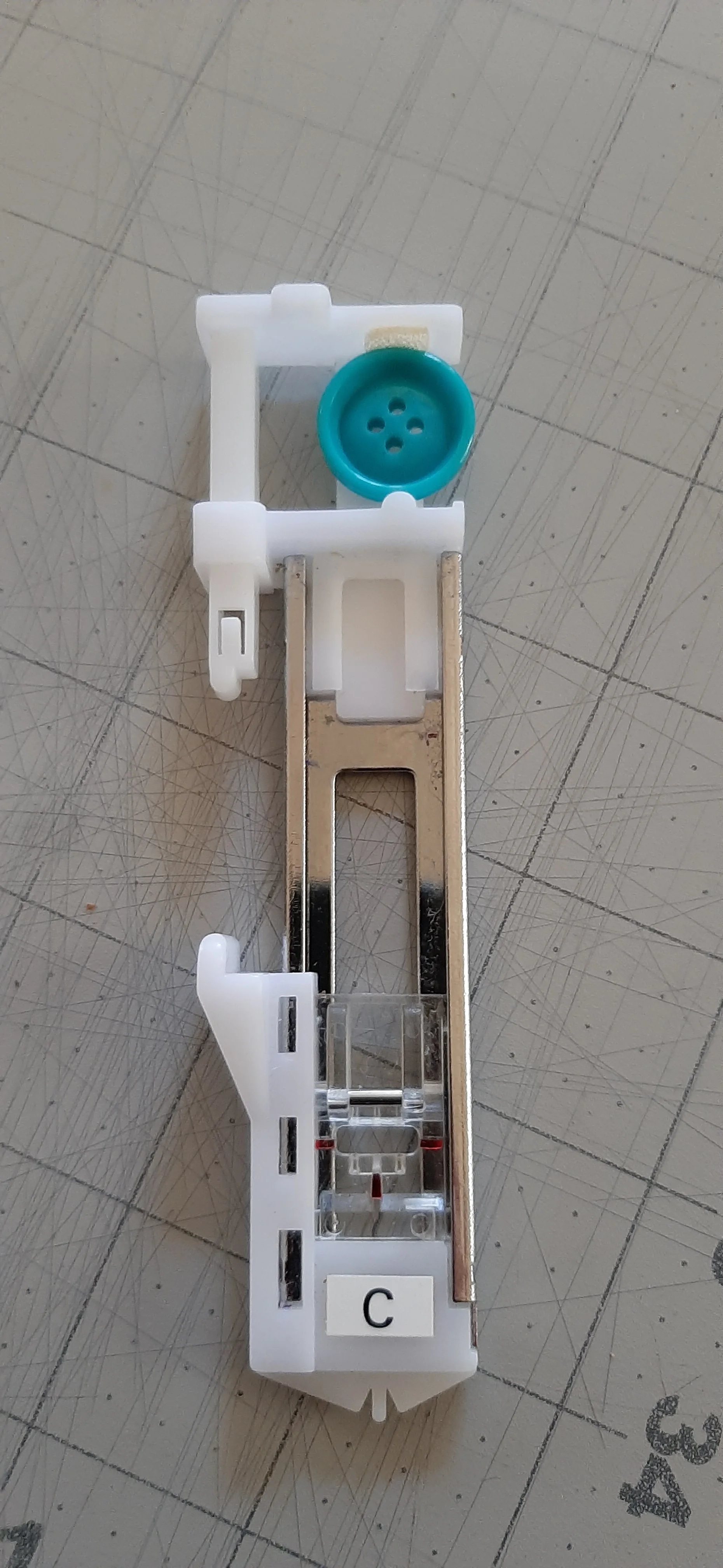

On my auto button hole foot, it requires you put a button in the rear of the foot. That area slides up and down to hold the button and controls the size it will sew.
To use it manually, you need to change to manual mode on the machine selection.
