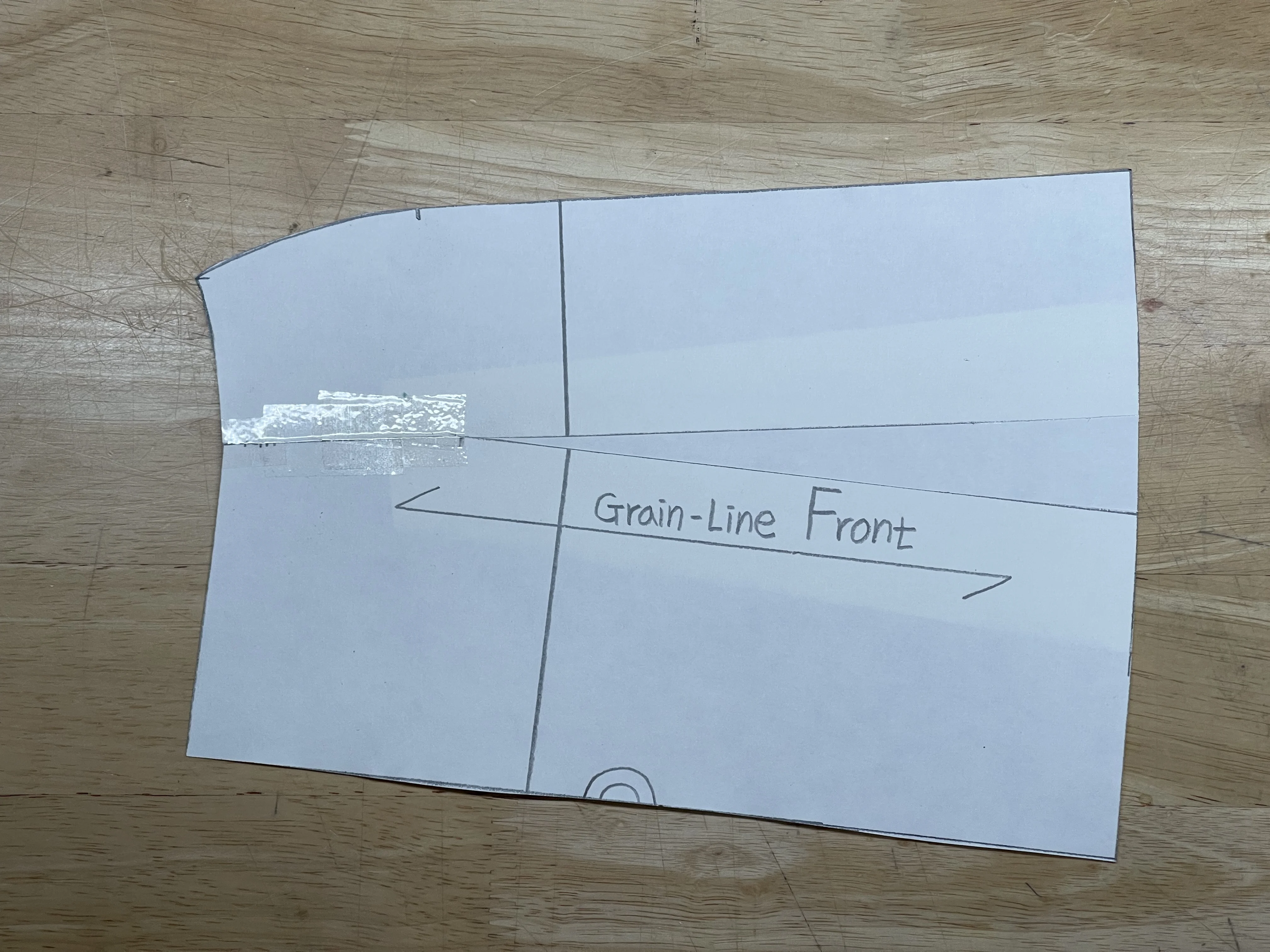

Following the Trapeze Skirt project, I would now like to proceed with drafting a Flared Skirt pattern as an application of the Tight Skirt.
There has been a change in size. The original size 88 did not fit properly, so I have adjusted it to size 99 (4XL). Although I am sharing the size specifications, the calculation method can be followed in the same way as before.
A flared skirt is constructed by closing the darts and spreading the hem. All dart intake from both the front and back panels must be completely closed. After adding the total flare amount and dividing it by four, the additional flare is applied to the side hem. The side seam should then be redrawn so that it connects naturally with the hip curve. In this case, I connected the added flare amount to a point 10 cm above the hem on the side seam.
I will further discuss the process of increasing the hem width after completing the basic skirt construction.

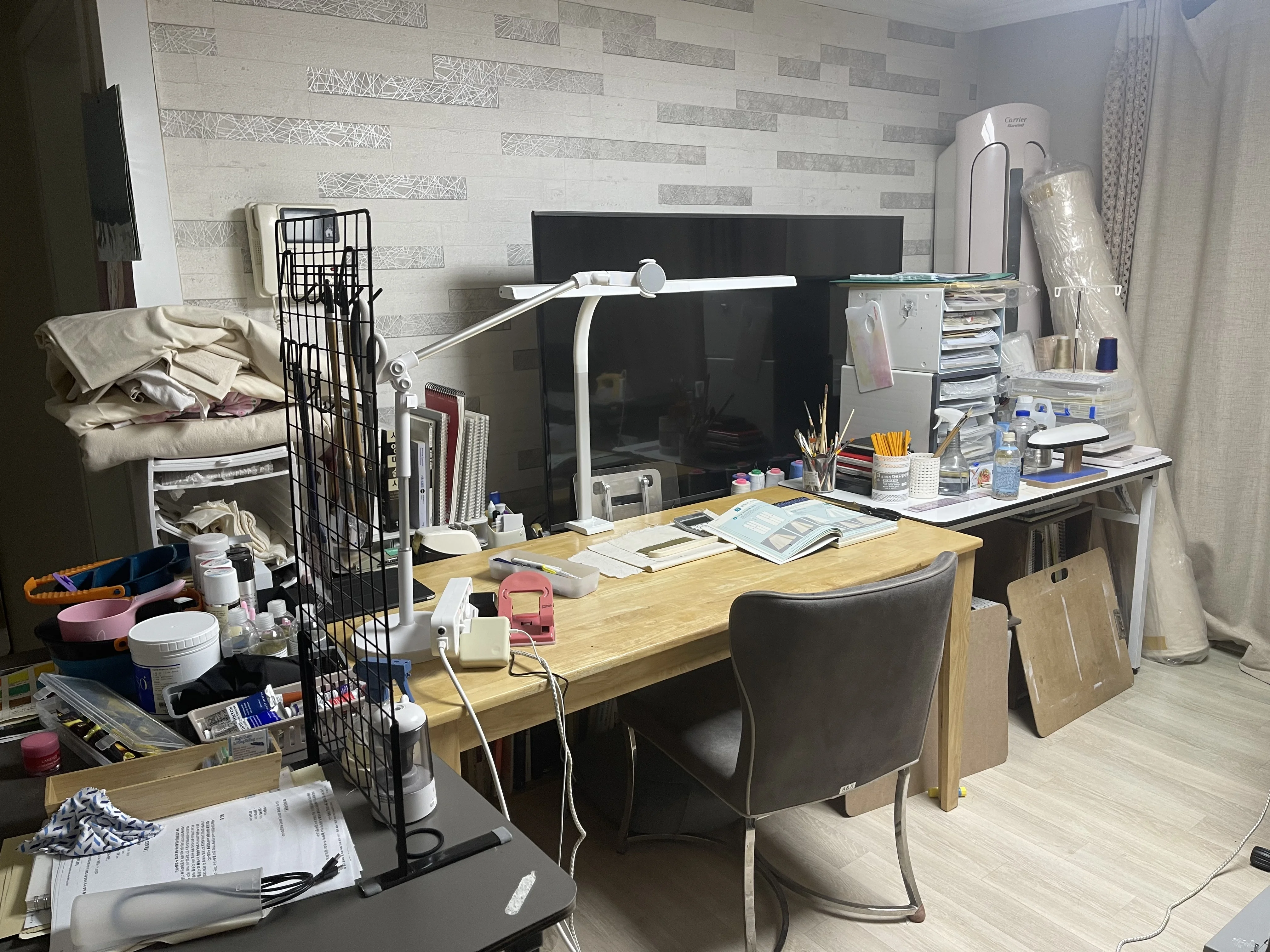

My workspace is a small studio set up in the living room of my 30-pyeong apartment. Originally, it was designed as a painting studio. However, after studying pattern making with the goal of sewing pajamas for my family and eventually starting a dog apparel business, I modified the space to accommodate clothing production as well. My ultimate goal is to make and wear my own pajamas.
- Waist circumference: 105 cm
- Hip circumference: 125 cm
- Hip depth: 22 cm
- Skirt length: 65 cm
